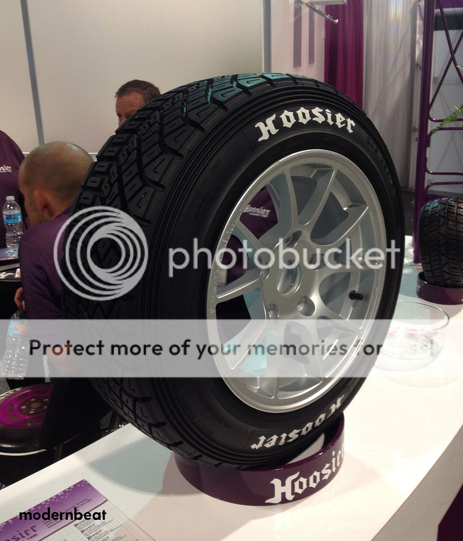

They had the tire on display at SEMA. Sound like they had done all the work for Euro compliance, but wanted to make a tread pattern change before submitting it.

Talked to Hoosier about this. The tread pattern has been approved by the MSA. And one size, the 205/65-15, is in production. I don't have a price or compound info, but will have a couple sets in a few months.
Here is the final tread pattern.
And the tarmac tire is going well.
With their recent acquisition by Continental Tire, they may have the capital to speed up development and offer some more choices.

Is it just me, or is the tread depth really... low?
I know we're all programmed to think tread depth is indicative of something, but it must not be everything since cold tires with tread depth don't work at all - so maybe it's all about pattern and compound?
But sure, I thought the same thing.
